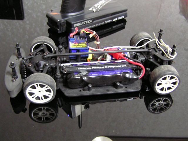

頭先試左車發覺唔係好穩定由其直線,第一次玩m18唔係好熟請問有無咩必改的零件,thx

minesr34gtr 發表於 2007-9-9 13:43:44 | 只看該作者
頭單,珠义,speed300摩打

我覺得你先要考慮一下換電變先,因為你果隻電要full雞後馬上殺車先可以停車,但係唔full雞就無法殺停部車,你可以試下!

頭先打散左部車!發現原裝支狗骨真係麻麻地所以決定第一樣要換既零件係狗骨,請問xray有無出過金屬狗骨?

原裝有出金屬狗骨,但係價錢都唔平!

另外我遇到一個問題,話說我成部車打散左再重裝,但重裝後發現前輪的狗骨杯位置右手邊好似比左手較短,當裝上狗骨時就出現
車鈴頂住上面A臂,請問知唔知咩事,係咩我裝錯左!請指教thx

你可以download說明書睇下自己有無裝錯!

睇咗似又無咩錯咁喎!老實講我對m18條狗骨無乜好感!個設計真係

如果你用現時設定就無問題,如果要加大馬力先換都未遲!

頭尾狗骨係咪共用的!
swkchow 發表於 2007-9-11 01:36:05 | 只看該作者
I have been running with the original dog bone for over a year with brushless motor without any problem.  It looks fragile but actually it's OK.
For your car, I think the first thing you need to change is tire => switch to sponge tire which can give you more grip, and thus should be more stable.

Another option to consider is the suspension spring and damper cylinder.  Original is too soft and the car is like a boat.  Try ATM short spring and their adjustable damper cylinder.
