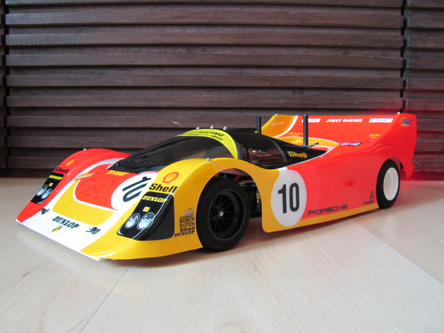

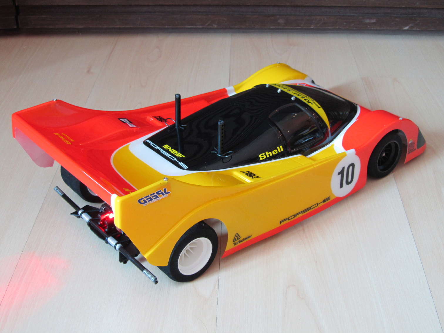

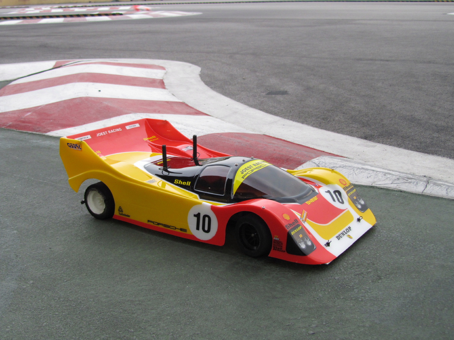

Many thanks to JohnnyC C-Hing excellent body work.  Here is a new toy to share (plus real pictures too .. )

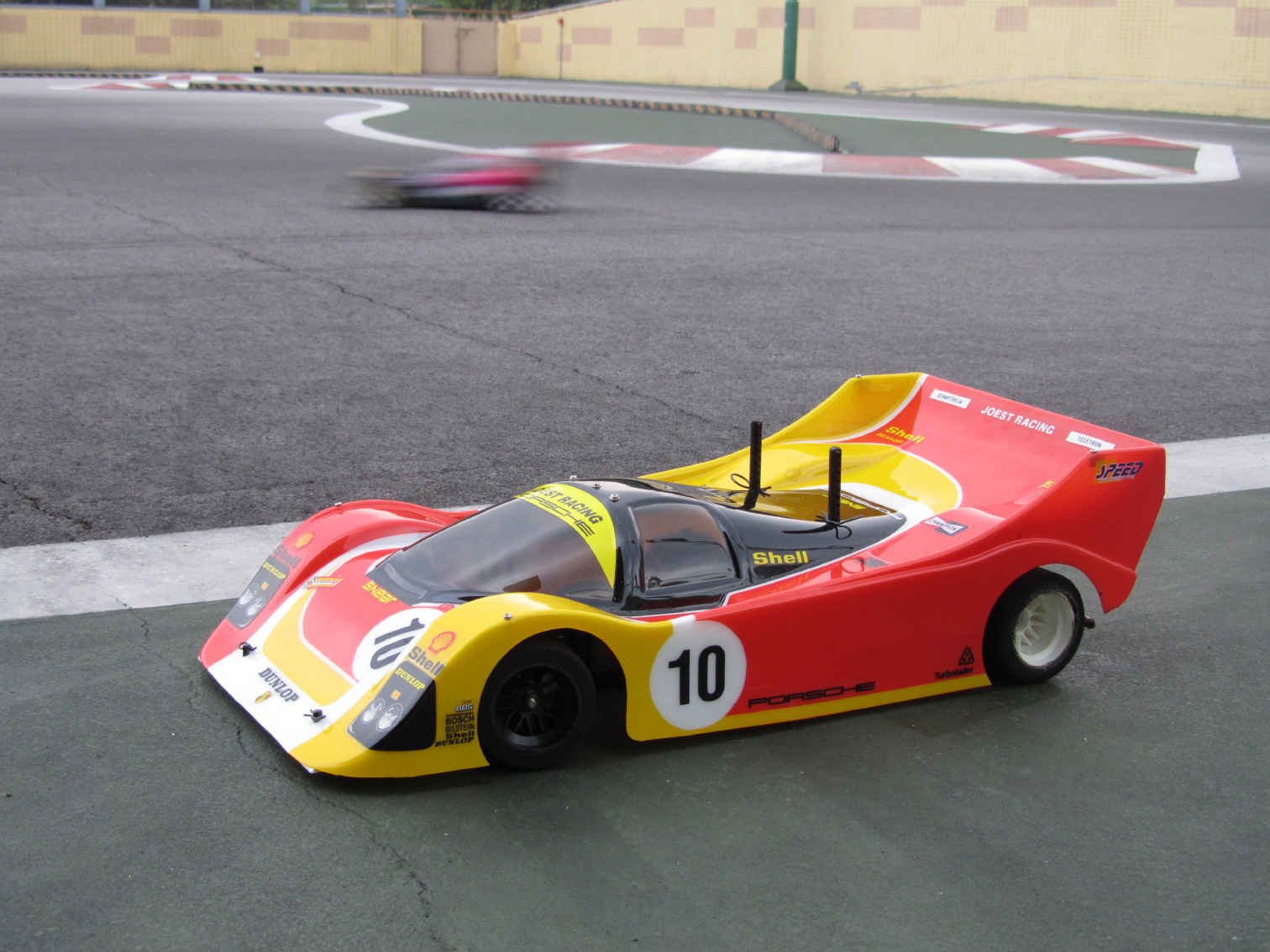

(ran well at JV tonight )

IS520 發表於 2011-7-10 22:50:13 | 只看該作者

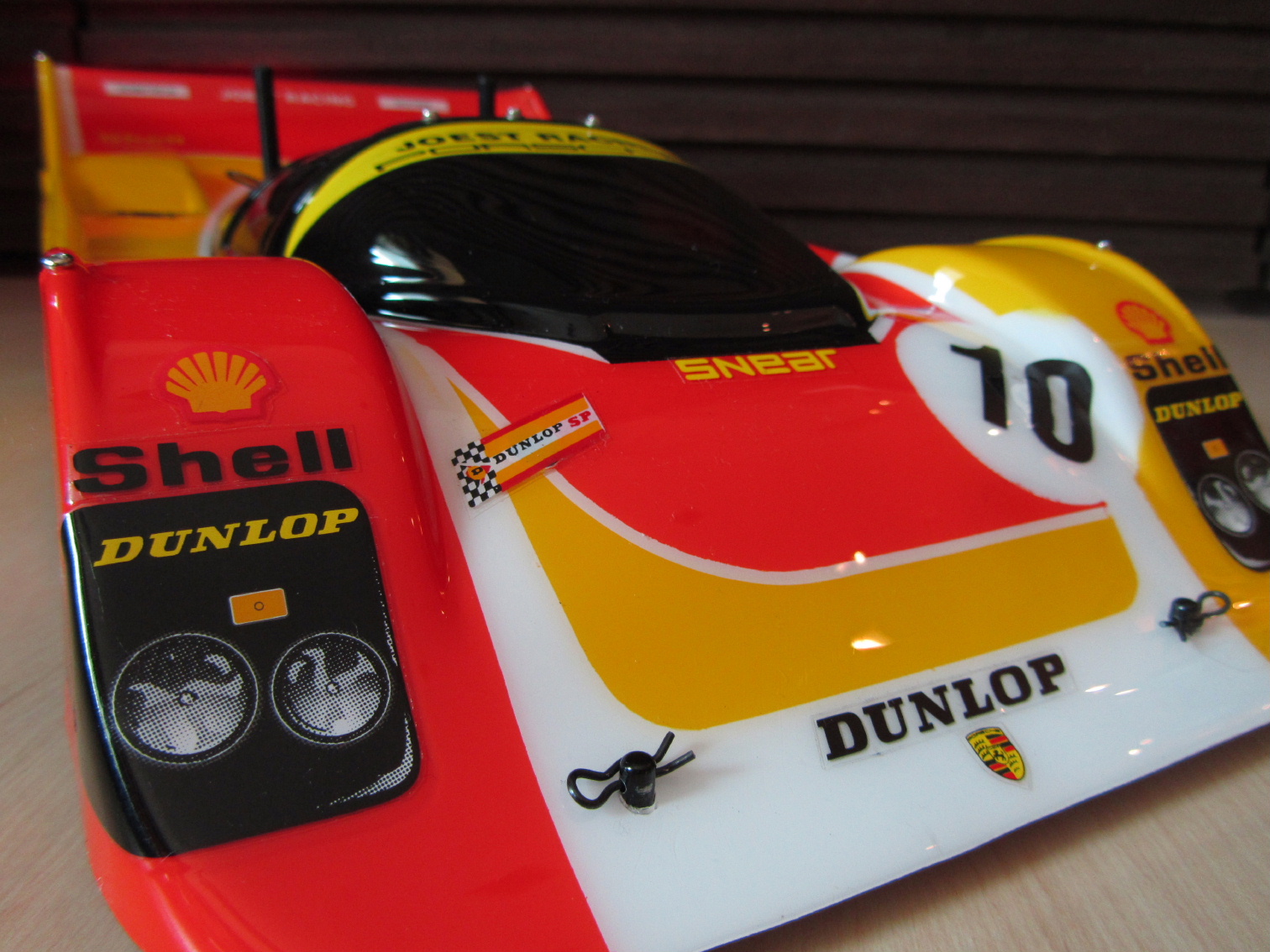

車殼上七粒螺絲有乜用?
 樓主| nel3838 發表於 2011-7-10 23:15:03 | 只看該作者
本帖最後由 nel3838 於 2011-7-10 23:18 編輯
Wahh CHing-sharp eyes wor...
The small screws are for "anti scratch", to protect the body.
(it is too nice maa..  )
manhunt 發表於 2011-7-11 00:15:05 | 只看該作者
anti scratch
does it work?
johnxxxjelly 發表於 2011-7-11 02:24:16 | 只看該作者
C Hing I saw your F1 tonight. Which tire did you use? My Gr.C keep spining when in full throttle at JV.
I used xceed medium at the front and soft at the rear.
 樓主| nel3838 發表於 2011-7-11 07:53:36 | 只看該作者
anti scratch
does it work?
Yes it does. Obviously not for big crashes.  The screws are positioned at roll over touch points, and if the car rolls, because the screws stick out for 1-2mm, the body is slightly kept from the ground, so reduce the cutting into the lexan plastic by the ground.  It's just a small but extra protection.
(and I guess it looks cool on top of window too.... )
 樓主| nel3838 發表於 2011-7-11 07:58:52 | 只看該作者
I used Zen front and back.  I tried exceed too, use hard front, and soft or medium back, and only tyre water at back.  However, zen combination is much bette.
johnxxxjelly 發表於 2011-7-11 11:50:35 | 只看該作者
Thanks. Will try zen front (hard) rear (soft) next time.

bigheman 發表於 2011-9-1 15:29:43 | 只看該作者
nel3838 發表於 2011-7-10 22:41
Many thanks to JohnnyC C-Hing excellent body work.  Here is a new toy to share (plus real pictures t ...
Ching , it is beautiful
Is that shell made by ABC ? Thanks

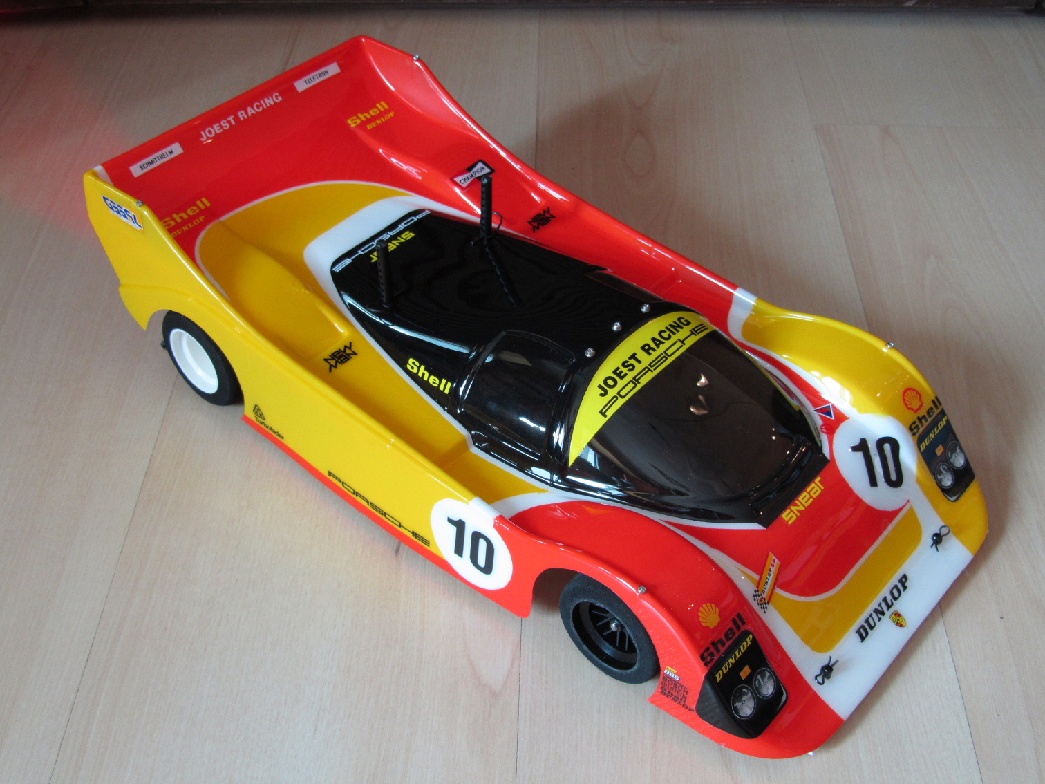

tiger1 發表於 2011-9-2 06:42:30 | 只看該作者
how come there are 6 small silver screws on the top of the body shell??
 樓主| nel3838 發表於 2011-9-2 07:25:43 | 只看該作者
Small screws for protecting body, at touch points, from scratches when the car flips over.

tiger1 發表於 2011-9-2 09:24:40 | 只看該作者
even with the screws, still 'ho lan'
