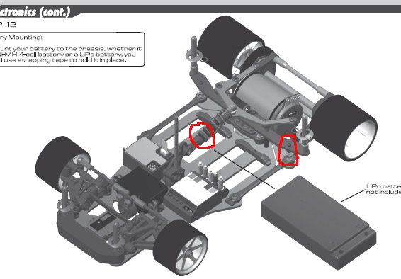

Any c-hing can share the following setting experience (Say, the setting in JV):
1) What is the depth of the set screw should be screw into the chassis brace (say, using silver side spring)?
2) What is the position of the shock collar should be place in the shock body? (It will affect the angle between chassis and lower motor plate)
thank in advance!!

side screw usually very little or no preload.  Especially if you use hard spring like silver....  center spring adjust it so the chassis is flat with rear pod.  If center a little higher than rear pod will give a little more rear grip.  But the car is less "predictable" when the rear end start to loose grip.

Side sprin is very funny, You can chose useing preload or not, And with preload you will get 2 times hardness  than non-preload
jf813 發表於 2011-7-26 09:51:18 | 只看該作者
ya...  just personally I don't really like to add lot of preload as this makes the steering too fast, not very stable.  I prefer to change to harder spring if necessary.  Just my 2 cents
