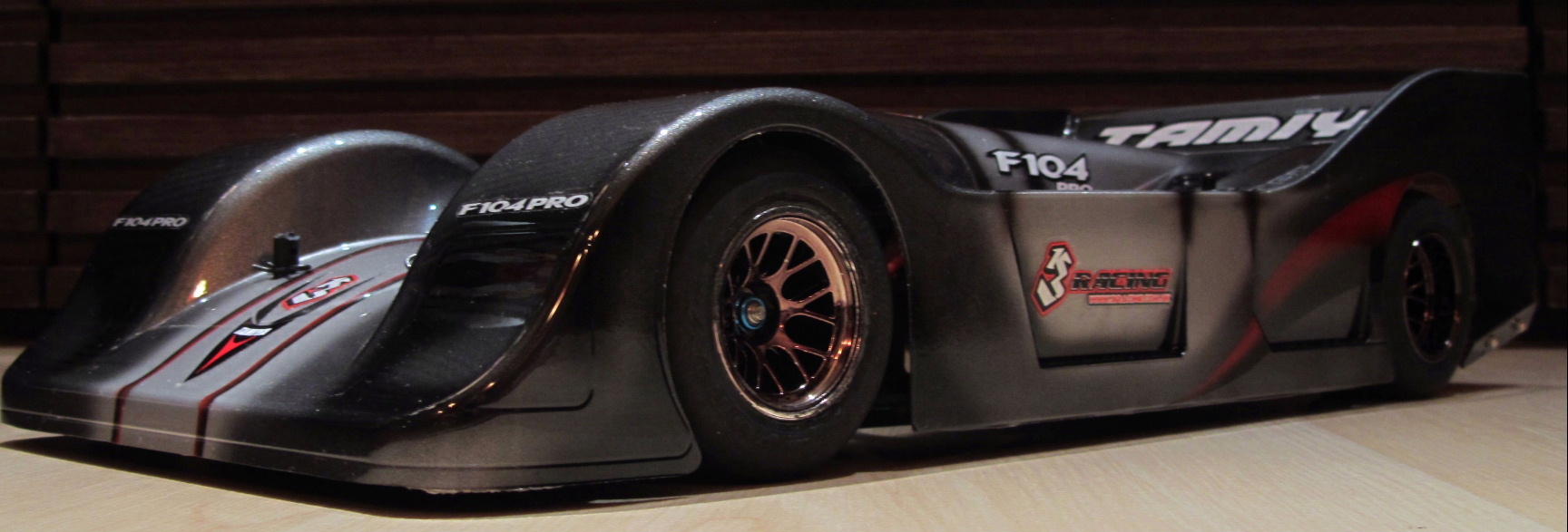

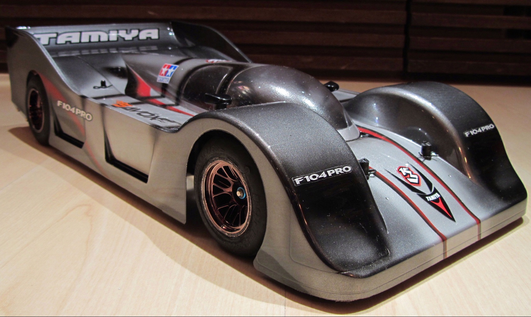

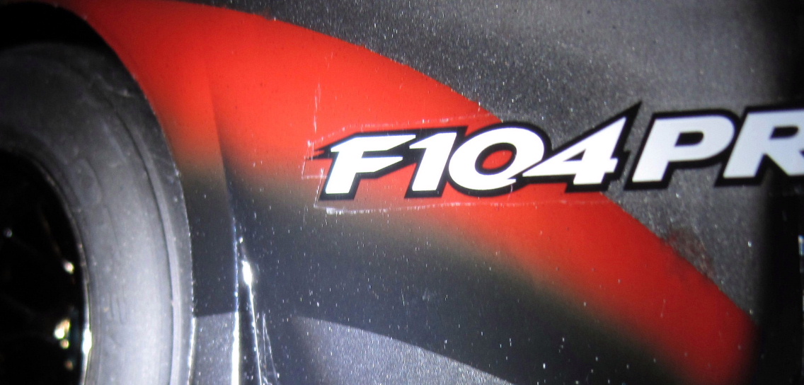

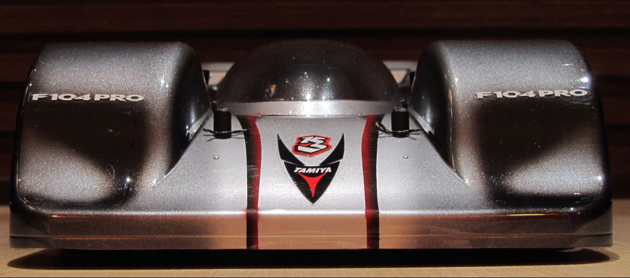

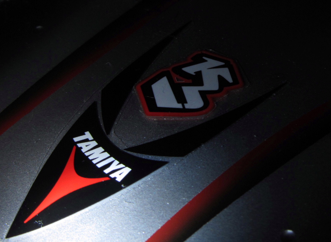

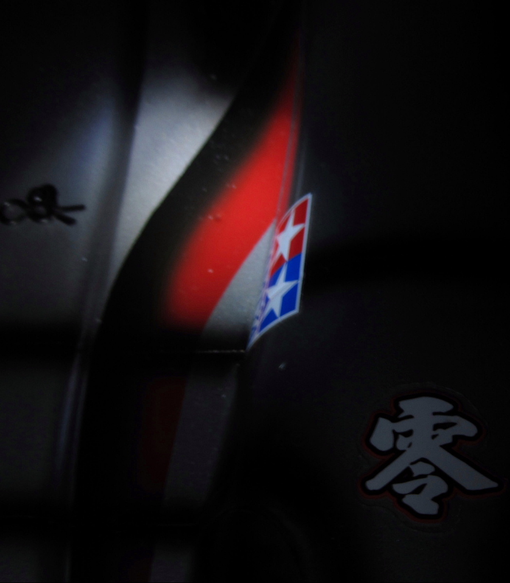

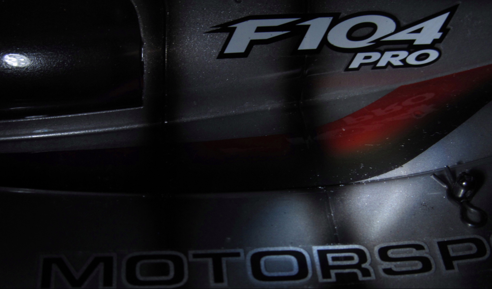

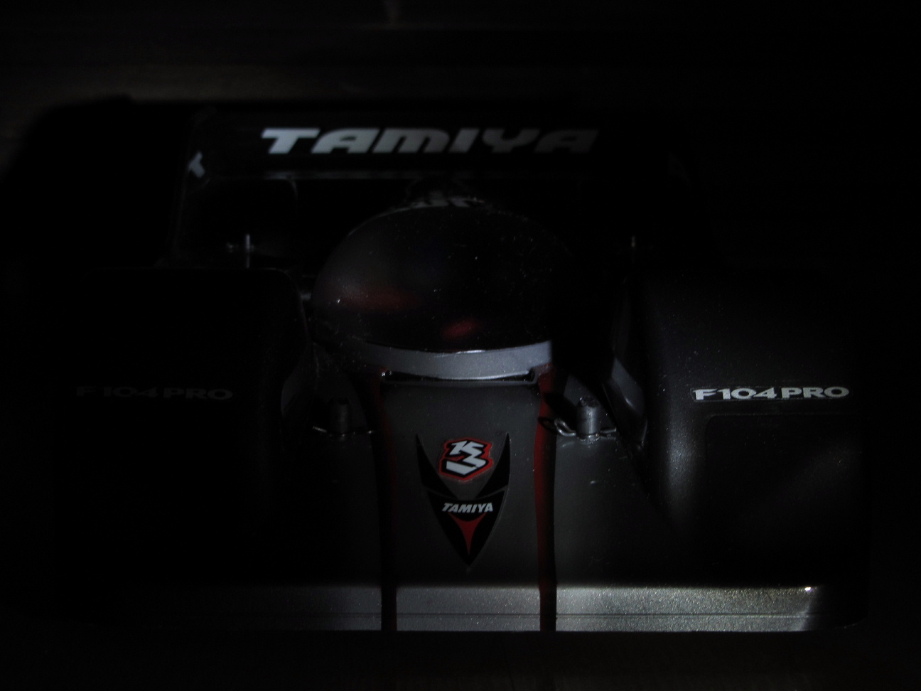

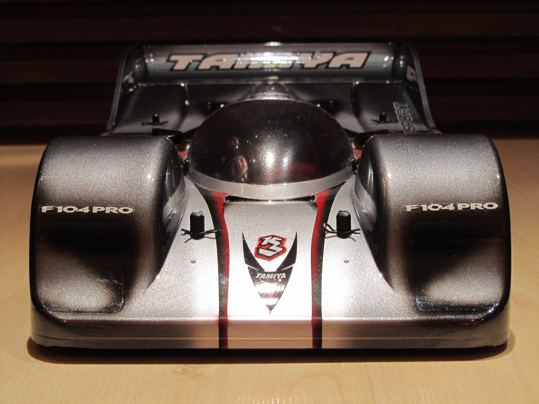

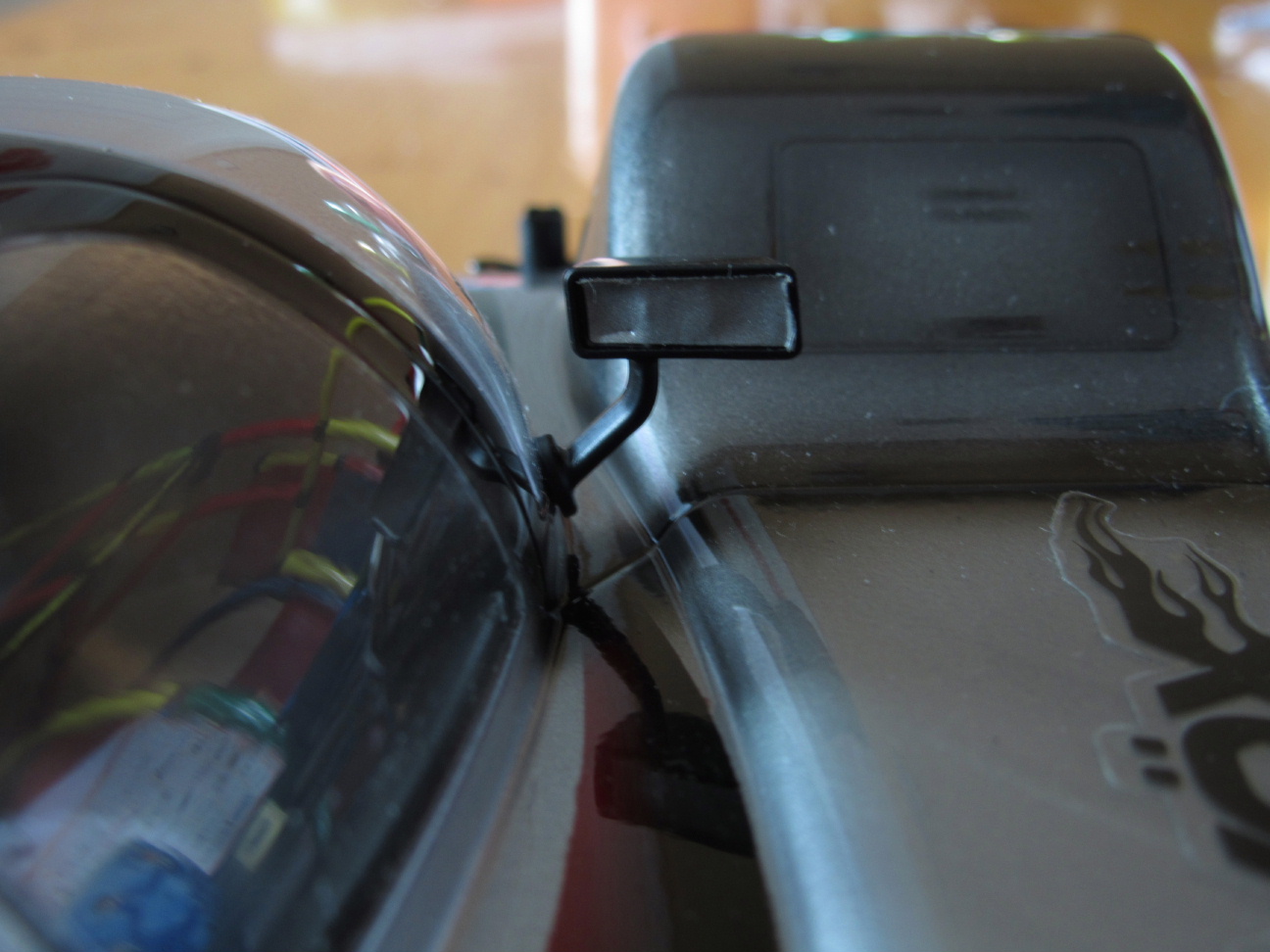

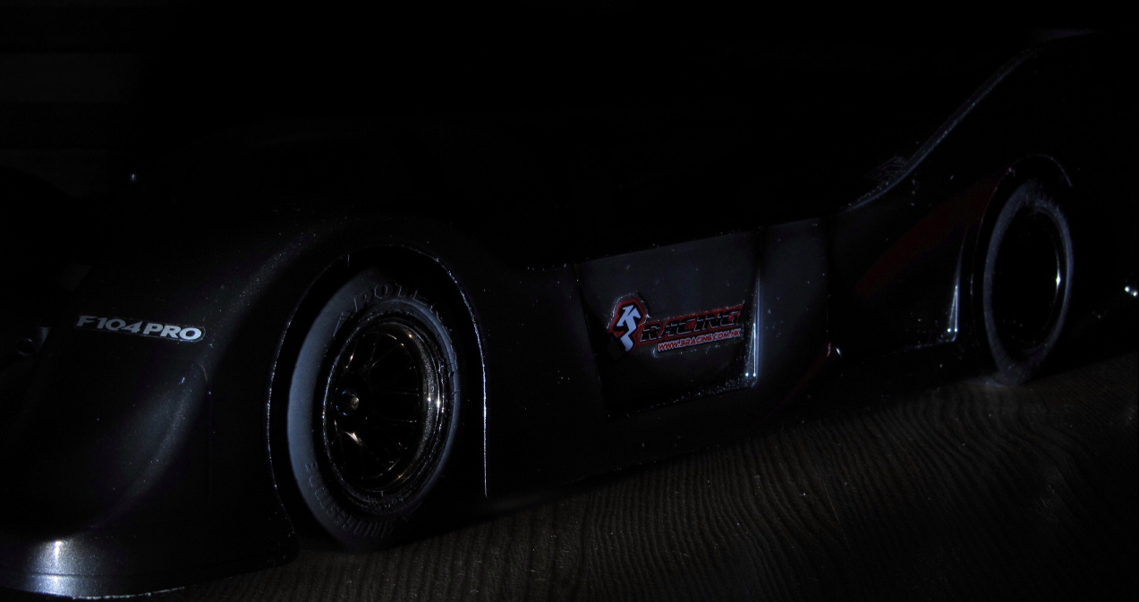

Just got time to upload a few photos of 变种F一零死 (F104). . . . .
more 裸体 later  ..  . .
吃喝玩樂 發表於 2011-3-13 21:58:00 | 只看該作者

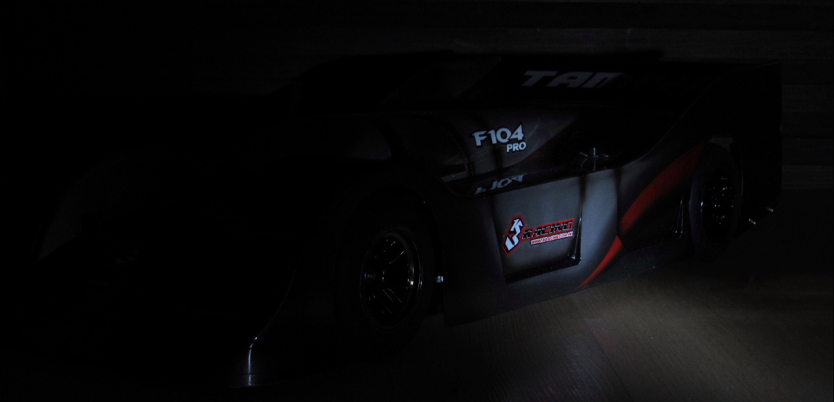

CHING影到架車好有神秘感

mansiu 發表於 2011-3-13 22:50:19 | 只看該作者
影得好正,好似人地果D新車發佈會咁
水都丸 發表於 2011-3-13 22:50:20 | 只看該作者
原來係你....

nice pics !

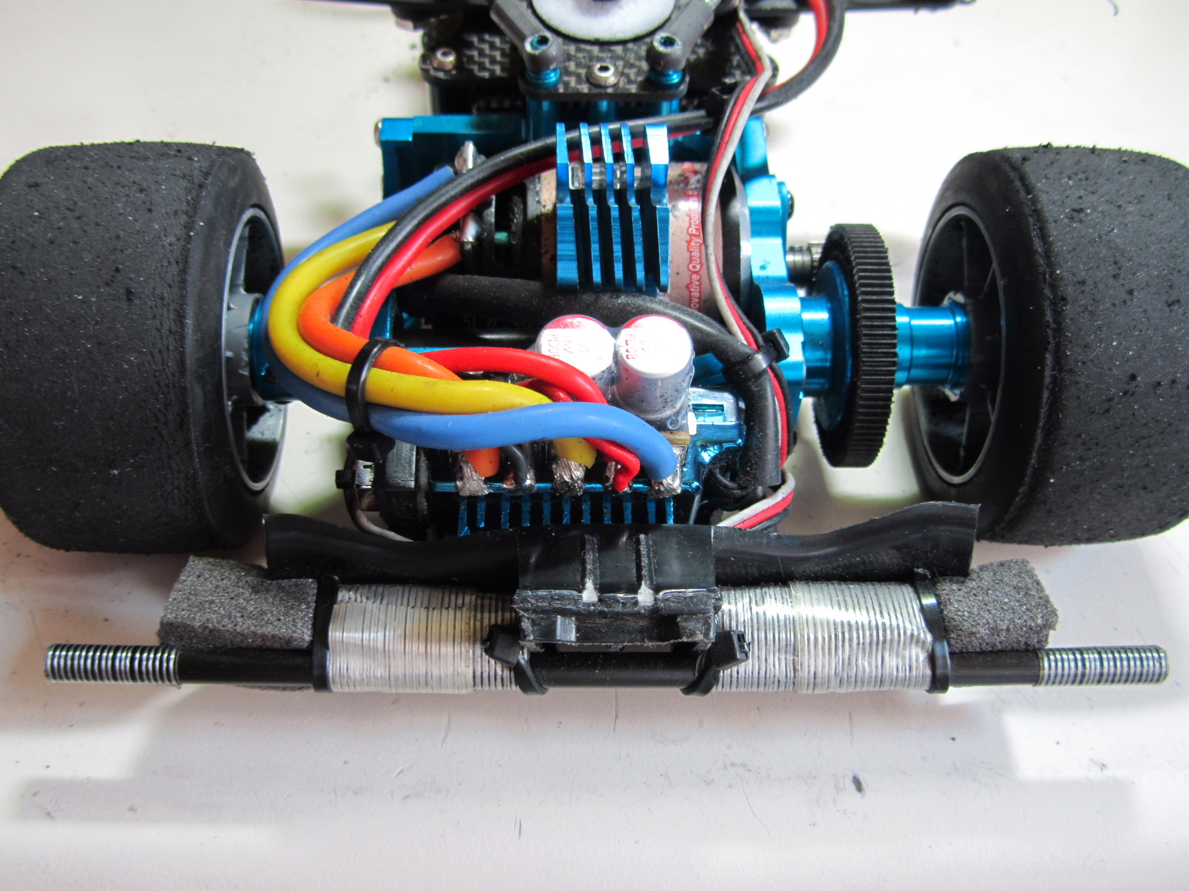

C-Hing  们, here are the 裸体 pet pet 照, 和全体照, sorry 久等

Very creative to put the ESC at the rear of the motor!
hk_sdu 發表於 2011-3-16 02:22
Thx C-Hing,
To share, this is a trial for three reasons:-
a - reduce of the weight L/R imbalance of the original F104 layout, therefore reduce need of using lead weights
b - increase weight distribution to the rear
c - reduce interference/imbalance of thick wires (3 brushless, 1 sensor wires) to the rear suspension setup (T-bar, spring/damper), and make the drive dynamics/feeling more predictable/consistent.
Downside of course is the exposed rear-end, so needed to put a big rear bumper to protect the setup.
So far the car runs fine at JV.  I am using 17.5, thou not quick but seems more stable to drive.

Yes, may be good for F104. But still need to have 2 long wires back to the battery.
hk_sdu 發表於 2011-3-16 20:07
Yes, there are two long wires and a remote signal wire.  Just to share, if any C-Hing maybe curious, I actually tested using a thinner gauge power wires (16 gauge), and was concerned if it may get hot.  After some tests with 17.5 T Turbo, so far it seems fine.
