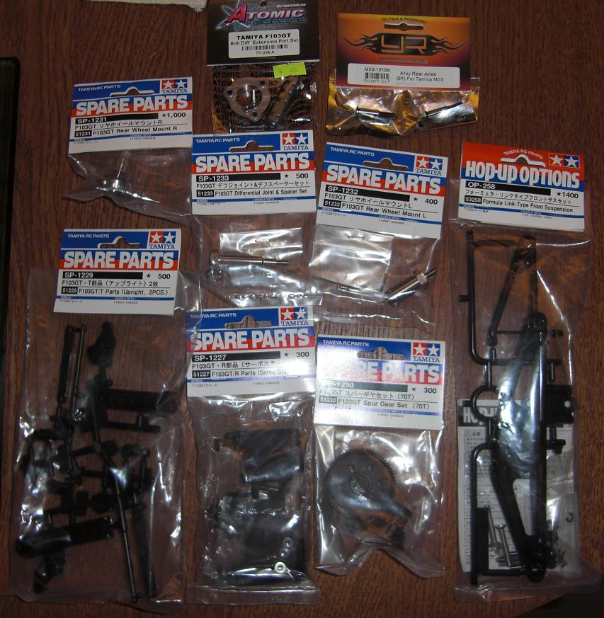

hk_sdu 發表於 2010-12-6 22:28:42 | 只看該作者
本帖最後由 hk_sdu 於 2010-12-6 22:32 編輯
The parts required to change from 103RM (F1) to 103GT
I just bought last week, most of them from Waigo
SP1231 - Rear wheel mount R, from Rcmart
The Atomic one is from Action Hobby, it is optional, for rear wheel base + 9mm
Around HKD 250+
Hope this help!
 樓主| whogetit 發表於 2010-12-6 23:00:47 | 只看該作者
本帖最後由 whogetit 於 2010-12-6 23:04 編輯
回復 13# hk_sdu
    好勁呀...咁我就可以去買新野玩啦
今個星期去照單執藥
hk_sdu 發表於 2010-12-6 23:51:38 | 只看該作者
本帖最後由 hk_sdu 於 2010-12-6 23:56 編輯
回復 14# whogetit
And this small bumper, very cheap
http://www.rcmart.com/catalog/rc ... l?cPath=595_744_888
From here, u got a full list of 103GT Tamiya part and hop-up parts
http://www.rcmart.com/catalog/tamiya-f103gt-c-595_744_888.html?page=1&sort=1a
One more thing, is the 3x37mm king pin, not include in the front arm set. This one is the same size as M-car susp pin.
