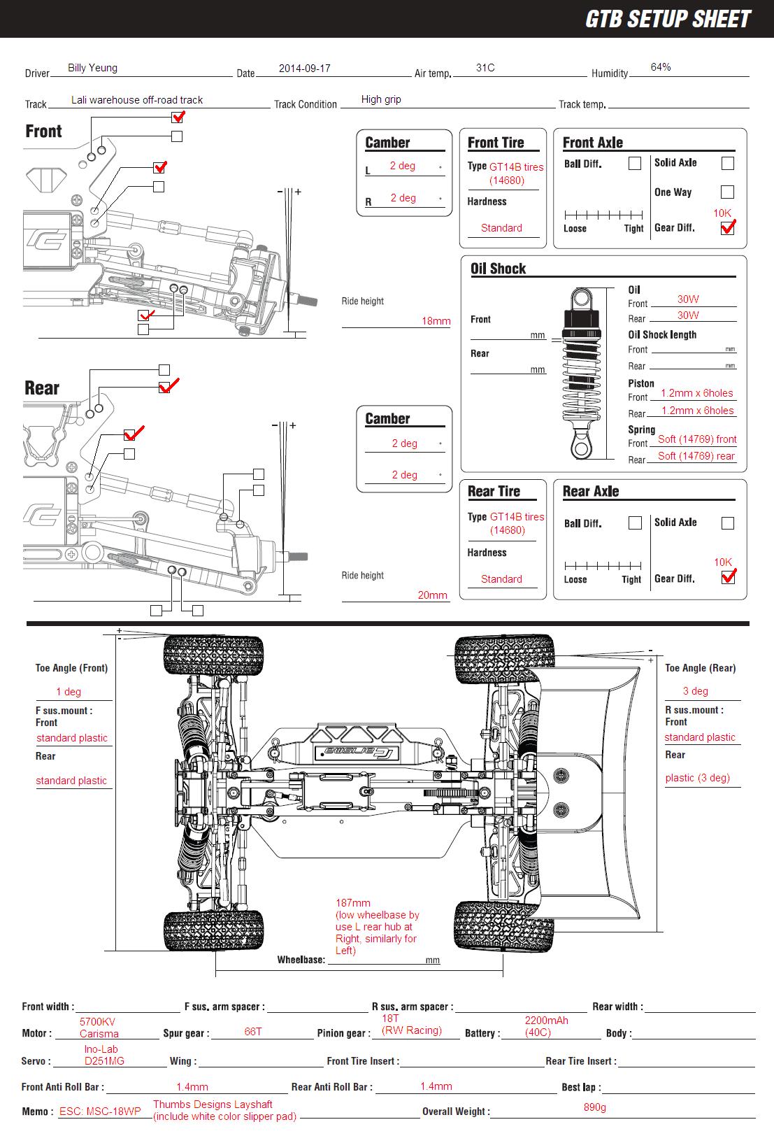

 樓主| RGear 發表於 2015-4-8 09:42:40 | 只看該作者
1234321 發表於 2015-4-8 01:41
請問師兄你部GTB有無改左D乜?另外你motor同esc都係用原廠?
My latest setting at Lali:
1) Powered by 2S LiPo,
2) ESC is Carisma MSC18WP,
3) Carisma 5700KV motor,
4) 18T pinion with stock spur gear,
5) front and rear gear diff, anti roll bar (Use the Carisma GT-14B's anti-roll bar)
6) oil shock with 30W oil, drilled 6 holes x 1.2mm
7) Servo = Ino-Lab D25-1MG (but this is not critical)
