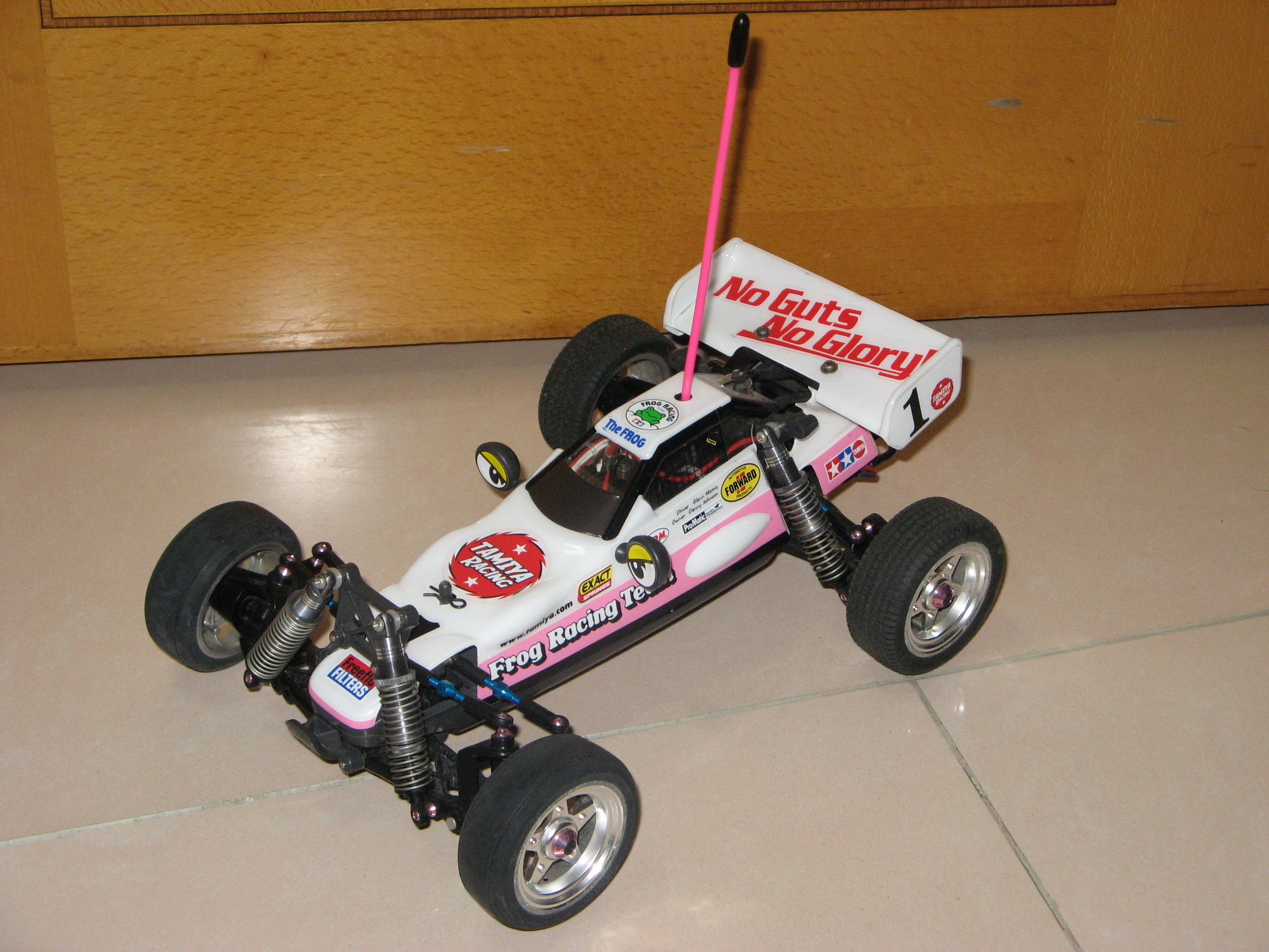

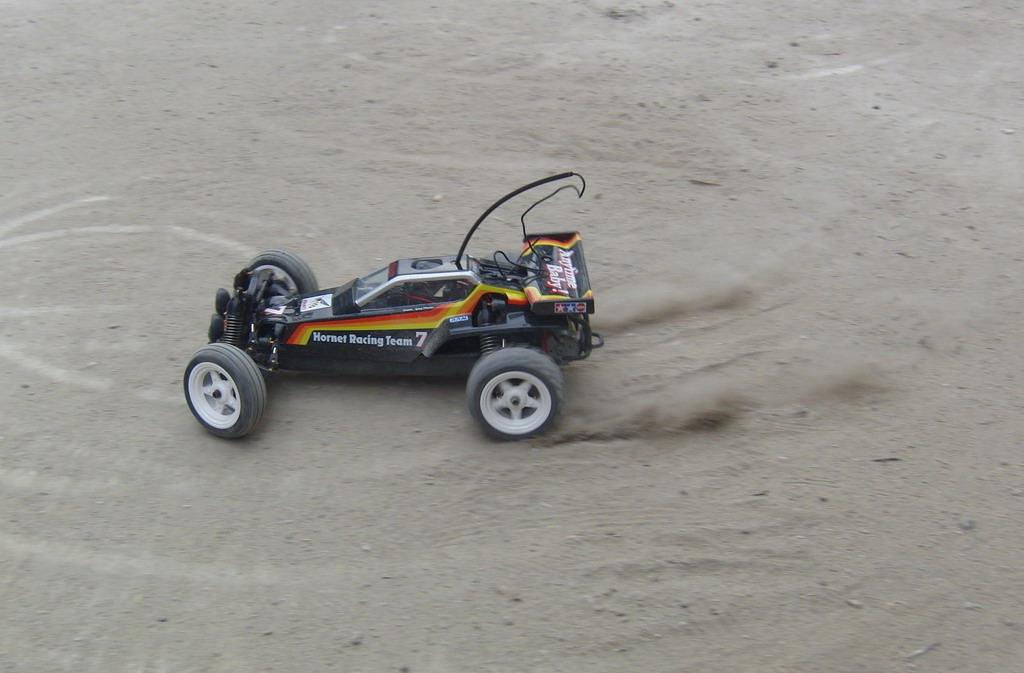

d.s 發表於 2011-1-30 18:46:08 | 只看該作者 回帖獎勵 |倒序瀏覽 |閱讀模式
好好玩!!
由八幾年接觸人生第一架 TA-02 4WD魔鬼魚越野車後再次接觸越野車,
TAMIYA TamTechGear ,雖然已經冇乜人氣,感覺有如死貨一般,
但玩落覺得物有所值,但眼見後援parts巳唔多,所以只能講句:[愛得太遲......]
 樓主| d.s 發表於 2011-1-30 18:47:28 | 只看該作者
 樓主| d.s 發表於 2011-1-30 18:55:08 | 只看該作者

Yes, Kit version is came with CVA damper, but I have purchased 3 Racinx as well, metal is better.
35度 2 holes with Hard spring for rear, 25度 2 holes with soft spring for front.
Remember, if you have a oil damper, you better to have a extra optional short spring set, not recommend for long version.
Motor hear sink is optional parts $7x.00 /set.  If you want to change the motor,  this is "must" items.  My friend was burned his 300V motor without the heat sink.

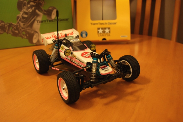

batcat 發表於 2011-1-30 21:43:23 | 只看該作者
My GB01 with optional damper
