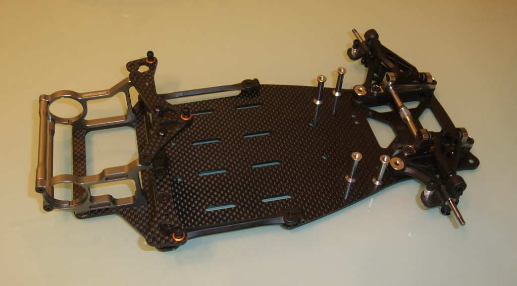

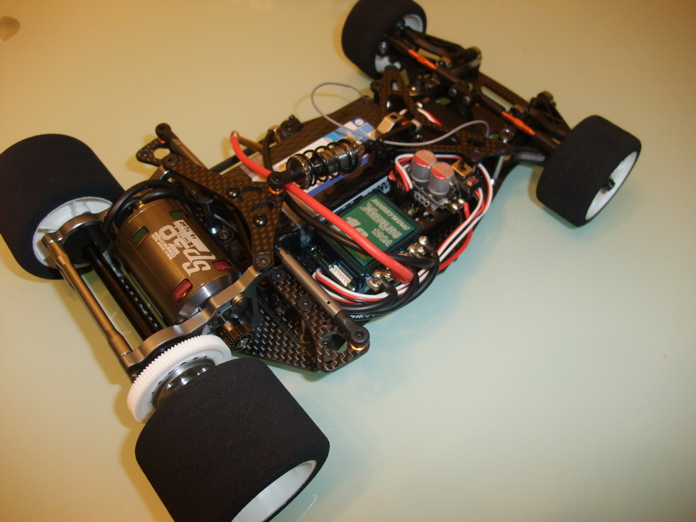

砌開孖星車,呢架12蛇真係有唔少地方難搞,
Motor mount果份option又跟少兩粒短螺絲....
Link彈簧果粒機米又好難扭上炭板....
林林總總.....
不過,我點都會努力搞好佢!!

Link彈簧果粒機米又好難扭上炭板,要洛一點油.同慢慢不能太急扭上炭板

自已會用粒同size大頭/杯頭螺絲慢慢做個牙形出來  跟住才用原裝粒機米螺絲收落去就比較容易和垂直.

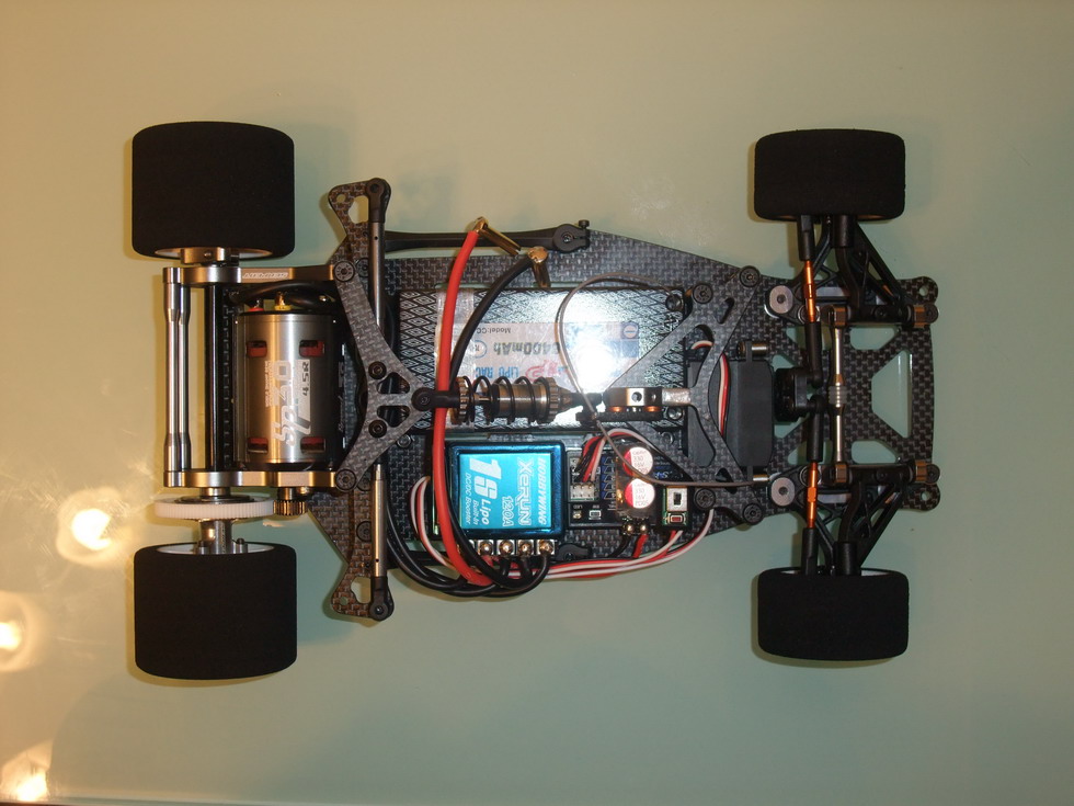

摩打尾果兩條柱是否原裝?隻esc 擰90°可能會好D,不喜細細力插...thx

是原裝option,esc 唔夠位擰90°....

You can try to rotate it 180 degree so that the servo wire and all the power cord can be shorter. If you use the solder post with different height, the wire to motor can be more tidy.
