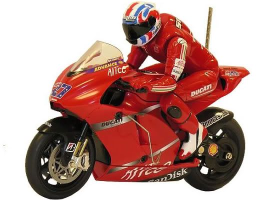

I discovered the 1/12 RC bike at HK international airport (Price $598) in 1/10/08, but I brought it in Mongkok until I back to HK, 14/10/08.
According the manual, it can replace the band. But I took it out, the band is not like general crystal (Two pin), it seems like mini electronic board.
行駛測試報告,
1, Speed is acceptable in this small scale.
2, Easy to control,
3, The transmitter can adjust the acceleration curve and braking curve, it is really useful and very creative.
4, It seems can not change bearing, because it is too small.
5, Battery can play around 8 minutes.
Suggestion Trips.
Remove the front wheel "C Ring" ,then remove the front wheel and the axle, add some bearing oil into the axle to reduce the fiction, it can improve the Flywheel performance and stabling.

係唔係比例轉向?
乜野motor?

係唔係比例轉向?
Reply: Yes 比例轉向, speed is also
乜野motor?
Reply: I don't know, not yet dis-assemble it.

我個FD 佢買咗, 仲改咗鋰電來係藍球場來玩, 速度對於佢比例來講適合, 唯不能轉太細灣.

改鋰電.....good,
Please suggest which 鋰電 is fit the size. Because I also search the fit size  鋰電.
How much? Where to buy?
Thanks.

鴨仔街, 應該係叫lithium Batteries, Ultra Fire, 3.6V, Like 3A Sizes. 兩粒自己焊電片和加插頭.

KF, I got one as well, let's go racing! I got band A, which band you bought?
I could'nt find the battery that can replace one by one, it should be a Nimh 4.8V 200mh type, so lithium one with 3.6 or 3.7V won't work unless you put 2cell in series (7.2~7.4 V)and add a regulator (step down to 4.8 V) but that won't fit into the body
作者: michaeltam    時間: 2008-10-24 07:30
我個FD 既做法係係鴨仔街買兩粒Ultra Fire Lithium Batteries(類似3A Sizes),  電片和插頭, 適合Size 既熱縮膠, 再買類似E Sky 既Balancer charger. 自行焊接. 無錯, 差滿是行 4.2V x 2 = 8.4V. 係唔需要Step down to 4.8V. 但架車行快咗, 玩過幾次無燒底板.

4.8V up to 8.4V, it seems very dangerous. Very easy to burn it.

KF, any report for the new battery? how mcun mah of it ?
作者: kfli    時間: 2008-10-25 23:42
標題: 回復 21# 的帖子
OK, no problem.
500mah. (But only can charge it near 200 mah, ah.... )
Enjoy to play it. Today charge it twice, speed Increase but seems playing time not so long for 500mah.
