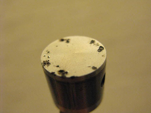

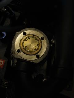

作者: erichow    時間: 2008-5-26 01:14
標題: 引擎內之異物
打開個散熱後
見到有啲粒粒野
好硬吓整唔甩
個啲係咩?點處理呢?
[ 本帖最後由 erichow 於 2008-5-26 19:24 編輯 ]
作者: erichow    時間: 2008-5-26 19:28

原帖由 erichow 於 2008-5-26 01:14 發表
打開個散熱後
見到有啲粒粒野
好硬吓整唔甩
個啲係咩?點處理呢?
我之前都試過類似情況,係粒啤呤散咗,啲碎片打到上盤,連散熱頂燃燒室周邊位置,都打到好似月球表面咁凹凹凸凸.

作者: erichow    時間: 2008-5-27 01:11
照玩又無問題喎,不過唔知點處理佢

原帖由 wai 於 2008-5-26 20:24 發表
佢把傘面咁靚唔似喎
如果真係粒啤呤散咗,啲碎片打到上盤會係咁個喎

原帖由 valklai 於 2008-5-27 10:42 發表
佢把傘面咁靚唔似喎
佢把傘面咁靚唔似喎
your case is that balls escape from bearing into the combustion chamber...

原帖由 erichow 於 2008-5-26 19:28 發表
your case maybe due to two reasons:
1) your bearing broken down already and some small fragments come from bearing to the cumbustion chamber
2) they are residues from manufacturing process but the manufacturer didnt clean it completely
How many tanks u have played already? U shall dissemble your engine completely and use fuel to clean it completely...and check the bearing by using finger to rotate the inner ring...if u feel gap movement from the bearing...u have to replace the bearing with new one...if ok, then go to play play....if u find the performance is still no good, u may need to replace cylinder and piston na
good luck
作者: erichow    時間: 2008-6-1 00:19
標題: 回復 13# 的帖子
thx
我只係喺第一次run計時有洗過咋
之後玩過五六個小時(總共),都無洗過
今日刷開咗嚟睇,bearing無事呀
同埋原來唔係有野黐喺道
係有表面傷痕,好似火山洞咁
繼續玩怕唔怕呢?用磨銅膏磨咗佢得唔得呢?
作者: serpent715    時間: 2008-6-1 00:51
好明顯bearing到期
作者: erichow    時間: 2008-6-1 02:09
點解呀?就咁粒bearing無野喎
作者: serpent715    時間: 2008-6-1 10:45
宜家係先兆你細心睇下D珠個面好(鞋)   吾換bearing繼續玩 D珠走出嚟 到時會打到入面散曬
作者: erichow    時間: 2008-6-1 11:04
咁係唔係換bearing就得喇
把( 遮 )洗唔洗換呀?
作者: valklai    時間: 2008-6-1 16:59
原帖由 erichow 於 2008-6-1 11:04 發表
咁係唔係換bearing就得喇
把( 遮 )洗唔洗換呀?
Yes, only replace the bearing is okay.
No need to replace the piston.
作者: erichow    時間: 2008-6-2 02:17
我未有工具整個bearing出離
麻煩師兄睇吓,係唔係真係要換個bearing
