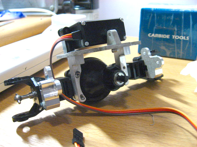

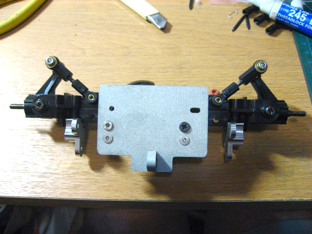

The conversion kit will come soon before this X'max!
Servo mount!
[ 本帖最後由 edison 於 2007-12-3 00:54 編輯 ]
作者: edison    時間: 2007-11-16 08:16
Axial mount

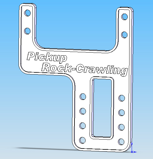

作者: edison    時間: 2007-12-3 00:52
Font Axial:
Real Axial:
[ 本帖最後由 edison 於 2007-12-7 23:48 編輯 ]

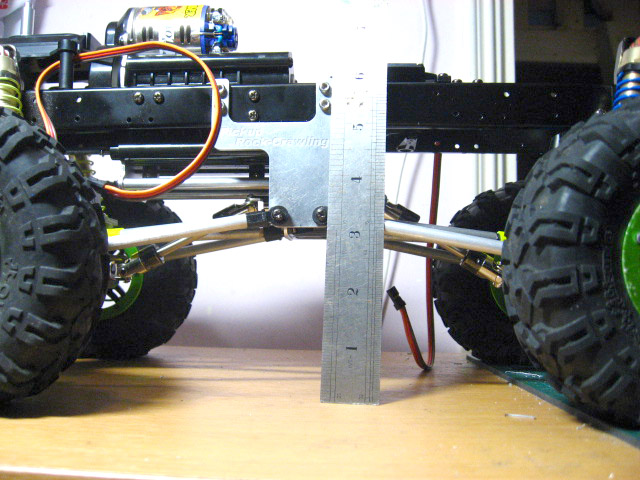

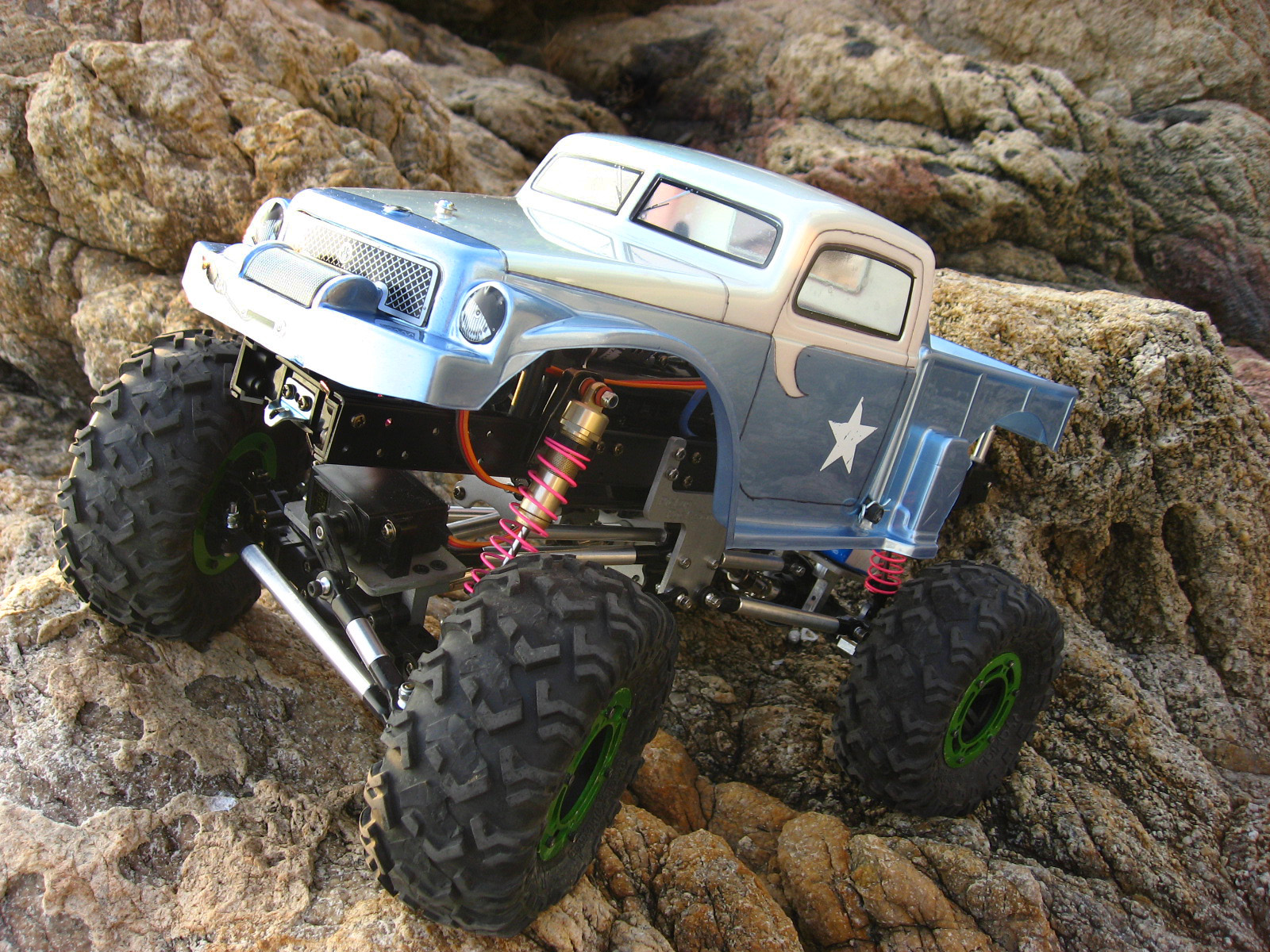

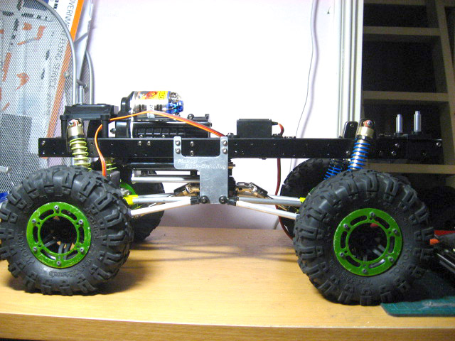

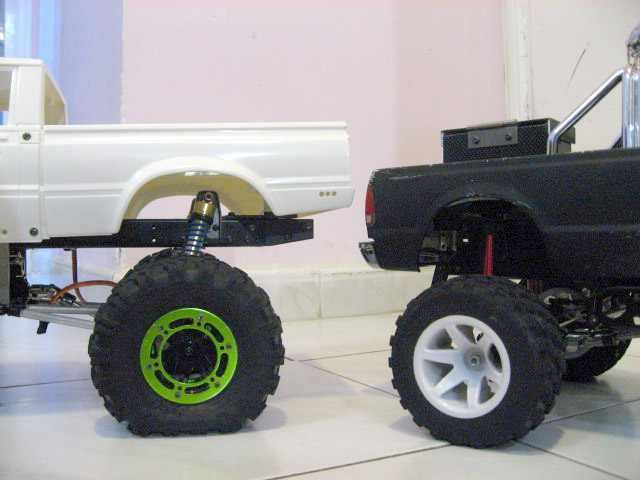

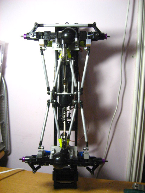

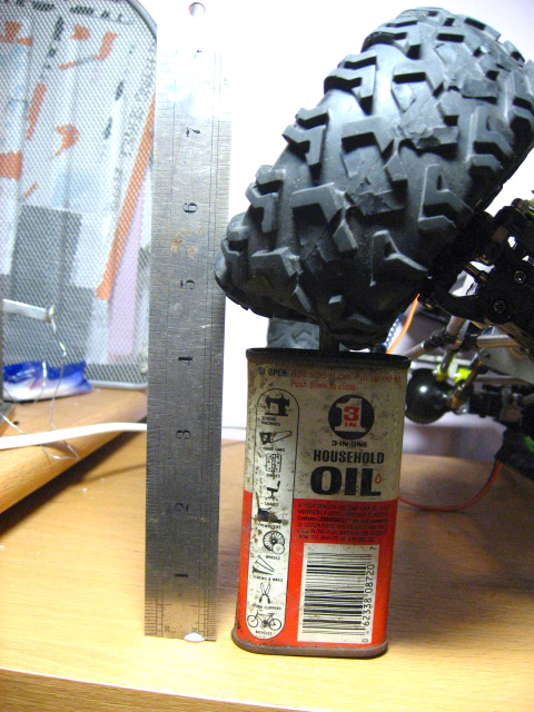

作者: edison    時間: 2007-12-3 00:58

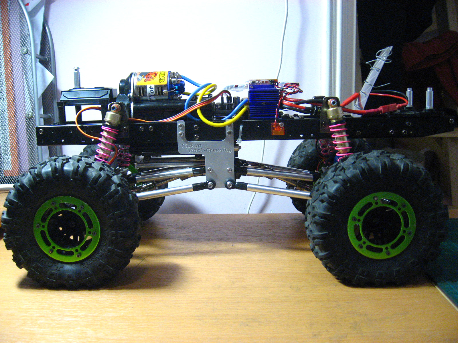

Chassis extender
Crawler Chassis finished.
Front Axial view.
Real Axial view.
Bottom view.
Climb up to 5inch.
3 inch hight

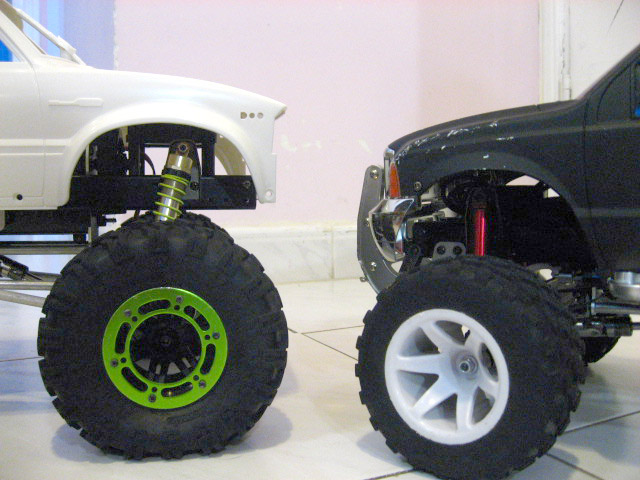

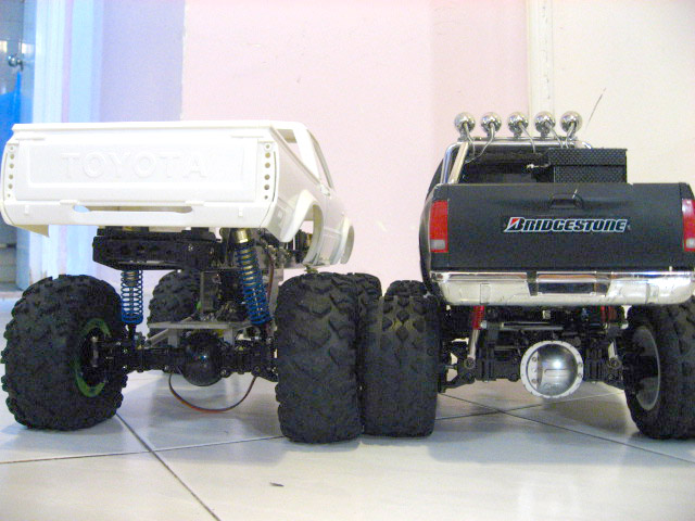

Hilux rock crawling preview.
Compare with origin F350.

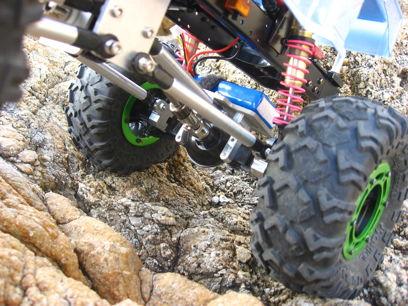

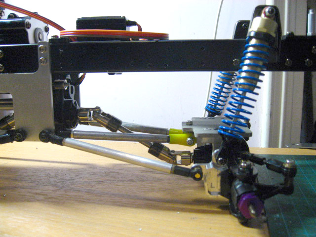

作者: go2usie    時間: 2007-12-3 10:11
標題: 回復 8# 的帖子
Also, have u measured the space left abve the steering servo? My measurement showed that the space is very limited and the servo will definitely hit something above in rough terrain........
~i agree with that.~

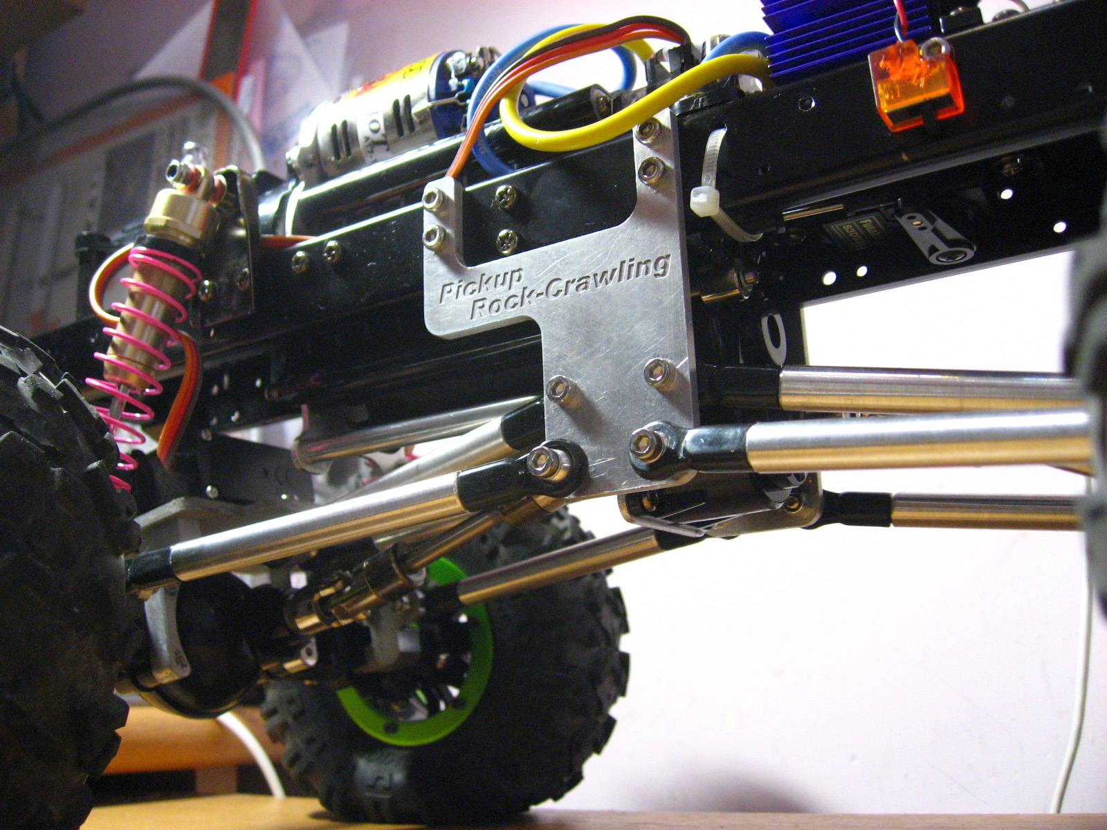

原帖由 sn-10 於 2007-12-3 10:03 發表
I'm not an expert but would like to point out one thing. In a real 4-link system the upper and lower links should be as parallel to each other as possible, otherwise the axle will rotate in articulati ...
Thanks for your professional suggestion.
Your concern is right, I was spent meny time to slove this problem.
because my design key point is No Cut, No drill, plug and play.
Right now the Caster shifting is between -4 to -8 deg in the axle articulation.
So, this the best setup for crawling. And also I had tested the car in wild.
The climbing capability is very very good! will post the video soon.
作者: edison    時間: 2007-12-3 14:54
原帖由 go2usie 於 2007-12-3 10:11 發表
~i ag ...
This kit already slove this problem!

原帖由 sn-10 於 2007-12-3 15:02 發表
how about the 萬向? can it rotate smoothly at that angle?
Yes!

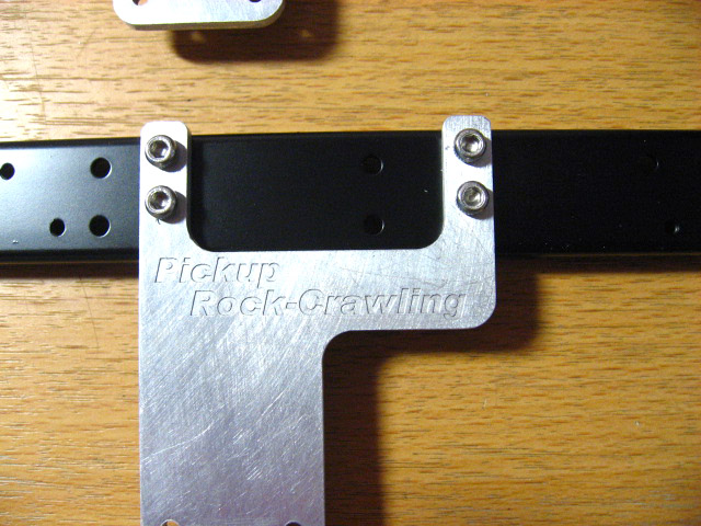

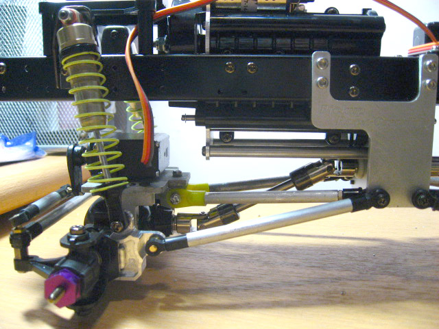

作者: edison    時間: 2007-12-12 02:02
Full set photo:
Here is the part list for the kit.
1. Axial mount L x2
2. Axial mount R x2
3 .Holder x2
4. Servo plate mount L x2
5. Servo plate mount R x2
6. Servo plate x2
7. Side plate L x1
8. Side plate R x1
9. Steering rod x1
10. Servo rod x1
11. Front rod x4
12. Rear rod x4
13. Ball join x10
14. full set screw
[ 本帖最後由 edison 於 2007-12-16 22:21 編輯 ]

作者: edison    時間: 2007-12-12 18:58
This is the final seting, and will using this revision to production
Test run:
作者: edison    時間: 2007-12-12 21:11
Test run video here:
http://www.youtube.com/watch?v=5MSwLz5Z83o

作者: edison    時間: 2007-12-26 01:48
Servo mount update outlook!
[ 本帖最後由 edison 於 2007-12-26 09:56 編輯 ]
