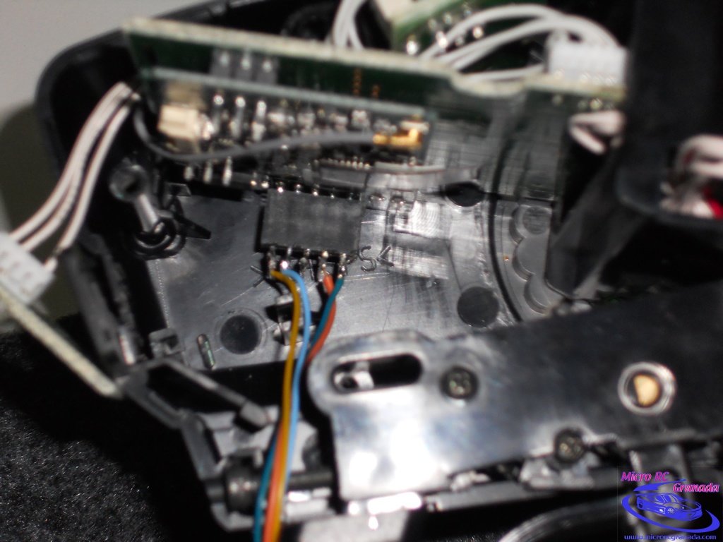

點解唔做個step by step分享下?
Futaba 4 PK -------->ASF 901sm Module
1 --------------------> 1
2 --------------------> 2
3 Not Connected
4 --------------------> 3
5 --------------------> 5
轉載 http://cafe327.daum.net/minizclub

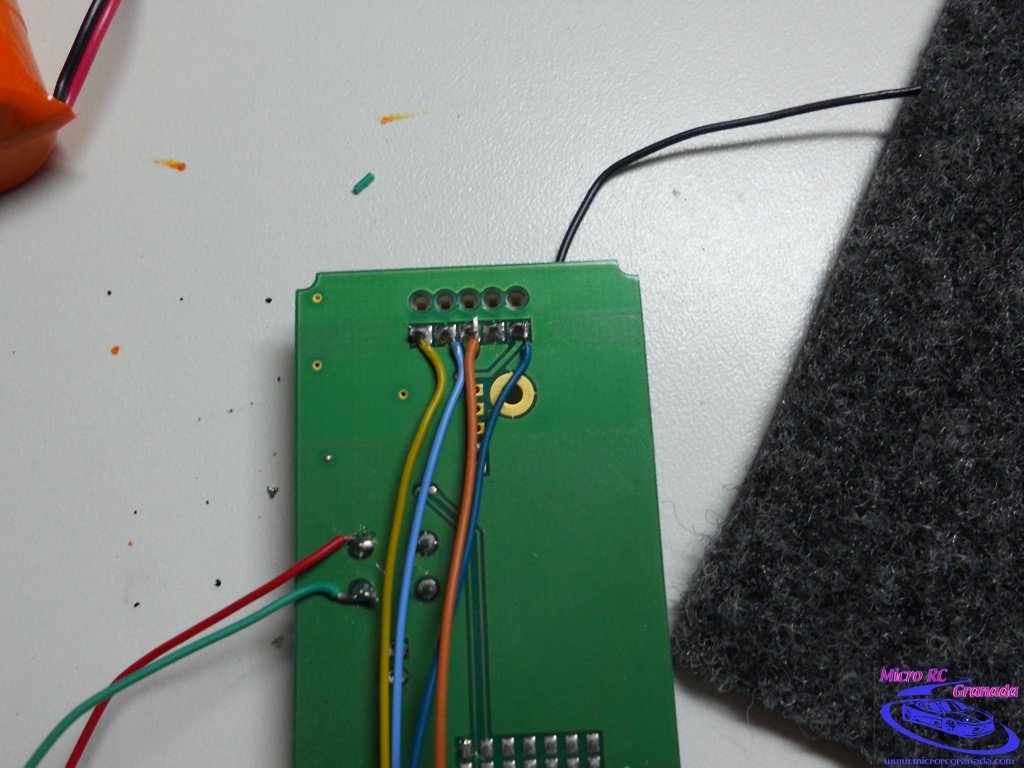

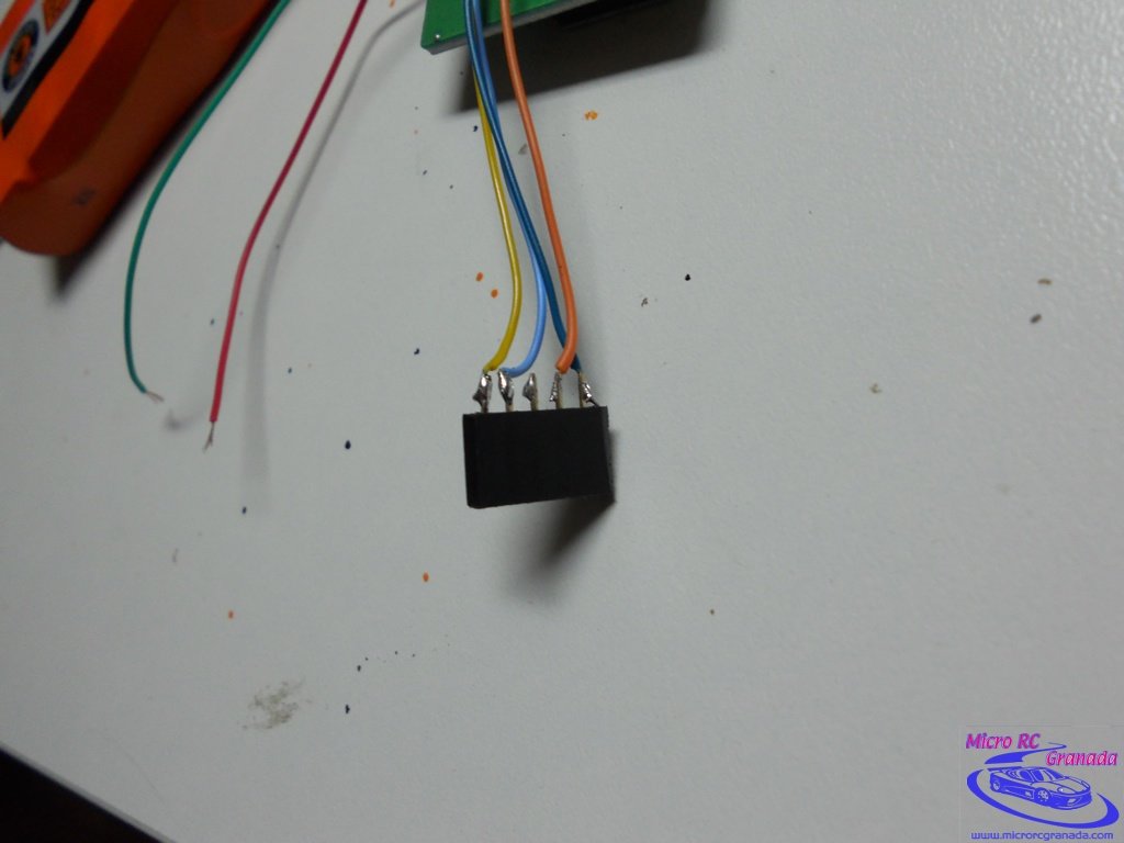

901SM Module pinout
1. Signal PPM
2. Ground
3. V+
5. Antenna
可以參考以下兩個連接
http://www.mini-z-guide.com/radio.htm
http://cafe327.daum.net/_c21_/bb ... p;nil_menu=sch_updw

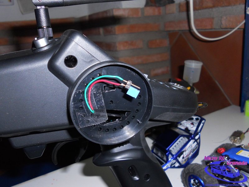

作者: hollowbean 時間: 2012-10-8 11:55
you're most welcome
add in "pair button" & “LED"
more info:
http://cafe327.daum.net/_c21_/bbs_search_read?grpid=IlZE&fldid=1LrF&contentval=0008f0008gzzzzzzzzzzzzzzzzzzzz&nenc=&fenc=&q=&nil_profile=cafetop&nil_menu=sch_updw
