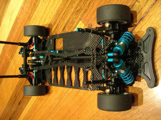

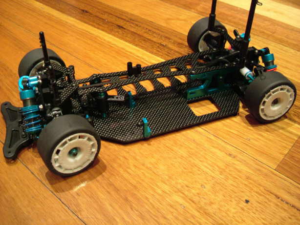

Just finished building my Tech Racing M03M conversion.
Easy enough to build. I think for the price it would be better value if Tech included a set of their shocks, or some universals.
[ 本帖最後由 Tim 於 2006-10-27 05:46 編輯 ]

 樓主| Tim 發表於 2006-10-31 04:16:28 | 顯示全部樓層
I worked out the cost and nearly died!
Lucky I had some of the parts already
You could save $$$ by using dogbones instead of universals, and plastic shocks instead of TRF units.
Tech Racing Mini M03 M Conversion kit: 29800Yen
TAMIYA 50882, TA04 KING PINS SET - 150yen
TAMIYA 51236, SUZUKI SWIFT SPARE BODY PARTS SET - 3200yen
Tamiya 51238 M03M F parts - 700yen
TAMIYA 51239 1050 BALL BEARINGS(4Pcs) x2 @ 500yen = 1000yen
TAMIYA 53255 M-CHASSIS 60D INNER SPONGE HARD(4PCS.) = 250yen
TAMIYA 53340 M-CHASSIS 60D REINFORCED TIRES TYPE-A(1PAIR) x2 @ 1100yen = 2200yen
TAMIYA 53341 MINI COOPER REINFORCED WHEELS(1PAIR)x2 @ 550yen = 1100yen
TAMIYA 53571 TRF DAMPER 4PCS FL COAT = 5800yen
TAMIYA 53597 M03 ASSEMBLY UNIVERSAL SHAFTx 2 @ 2000yen = 4000yen
Total cost: 48200 yen … oops that's without plastic hex drives to hold the wheels on!
