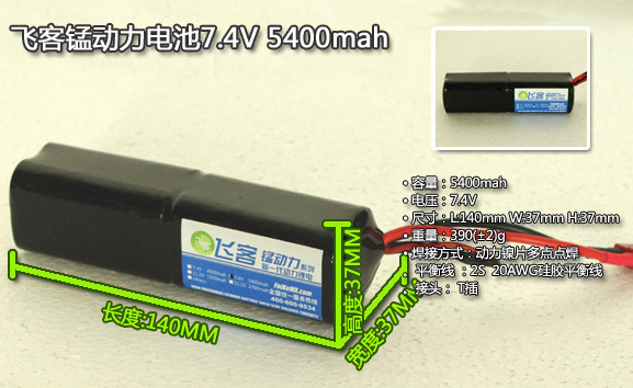

作者: snipertat    時間: 2010-10-10 10:38
出左新野
唔知幫唔幫到C兄
http://item.taobao.com/item.htm?id=7810571470.

Ching, is it similar to LiPO or LiFE ? How to charge ? LiPO mode ?
What is the advantage s??
