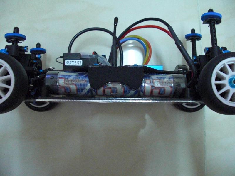

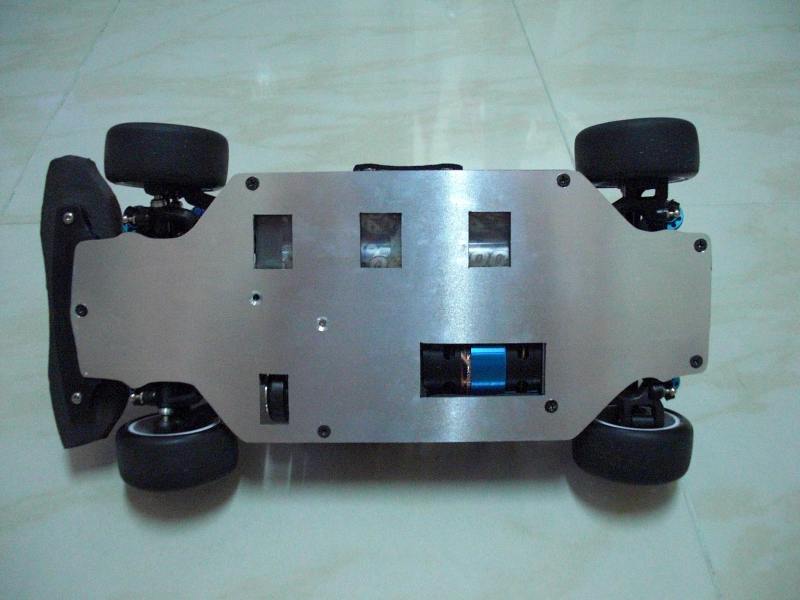

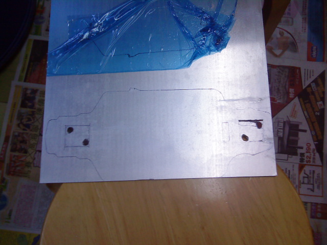

艱苦經歷.......TT01-M

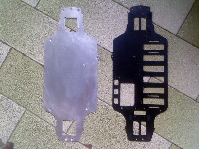

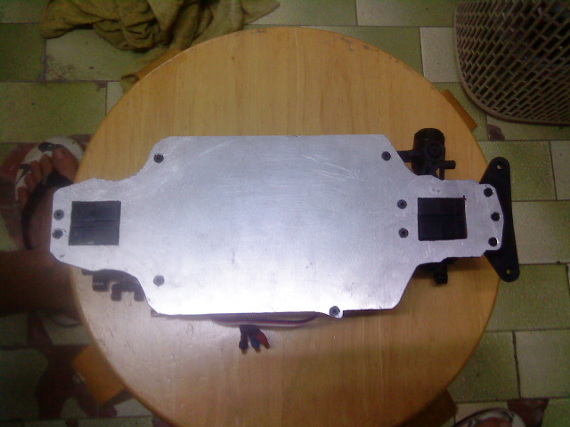

DAY ONE:
original frp chassis is too soft
hand made a 2mm Alum. chassis..........
TO BE CONTINUE

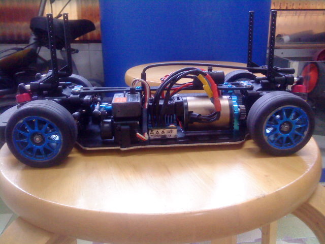

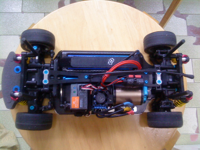

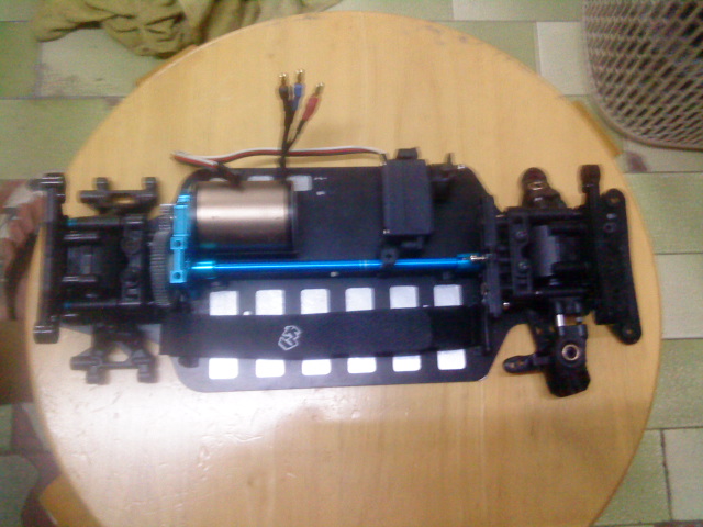

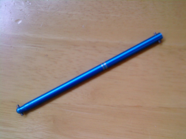

DAY 2:
hand made main shaft
build up the chassis

Angtr 發表於 2009-6-4 04:10:30 | 顯示全部樓層
just an advice!  your aluminium sheet will not able to take impact, as those are not heat treated aluminium, will twist and band easily, strongly suggest you  use stronger upper deck.
Original TT  f/r up rights are ok, if you got spares bucks, good way to buy aluminium f/r up rights.
appreciate your post, I m also using alu sheet for off my buggie under trade protections.
wingwing 發表於 2009-6-4 13:53:01 | 顯示全部樓層
精神可嘉!不過鋁板一撞就曲,C hing 要有心理準備。

要轉金屬parts......建議連差速齒都換埋其他touring的牙差齒,咁就可以用普通o既金屬差速杯連接萬向。

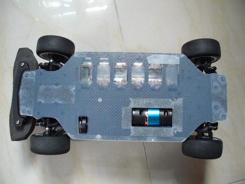

本帖最後由 raymen 於 2009-6-4 16:38 編輯
This is a very good idea , I do almost for all my cars .....   except Buggy!
Draft
Draft
DIY 1.5mm soft alloy bottom plate
1.5mm thick
1.5mm thick
smallfaifai 發表於 2009-6-4 15:41
then the cost to make the TT01M is very expensive wor!
 樓主| koji1230 發表於 2009-6-4 22:48:38 | 顯示全部樓層
18# powis
agree
i use original 差速齒 ja
i don't want put much $ in this car
not worth!
