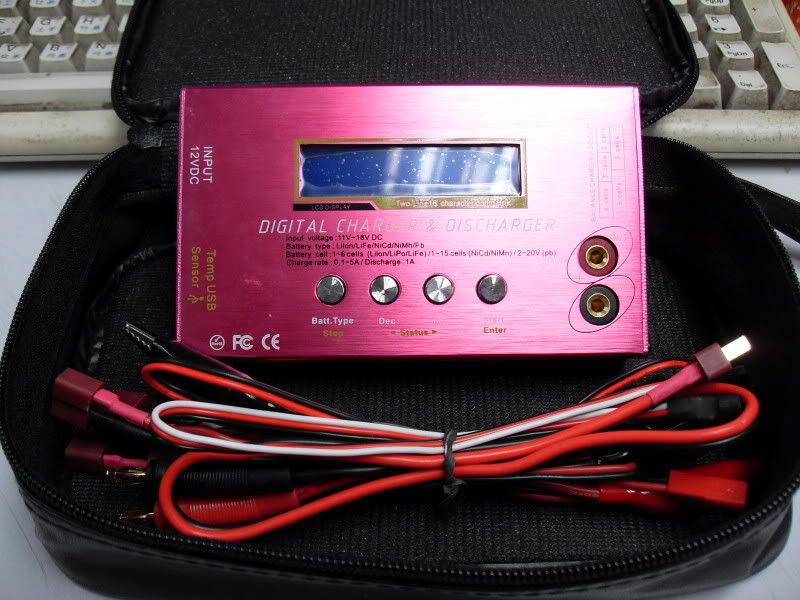

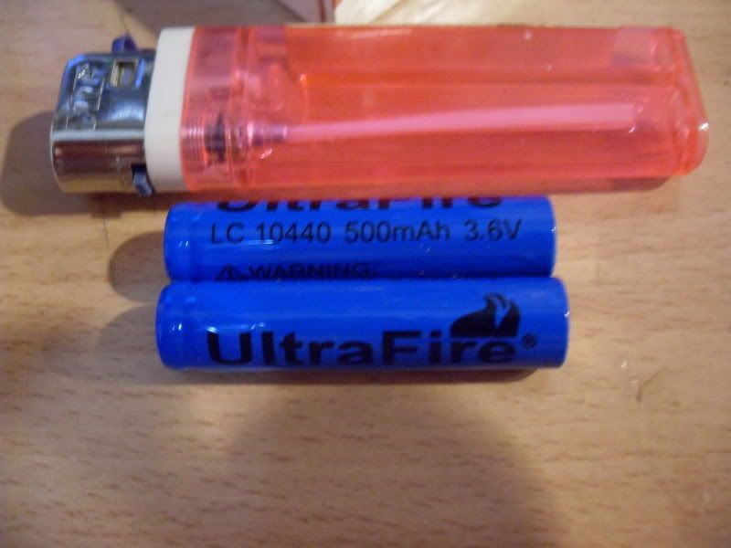

請問3A鋰電, 可以點差? 可否用圖中的差機差電?
是吾要銲平衡差白插+T插?

use Li-Ion mode = Lithium Ion (3.6V) @ 0.5A charge rate.

唔該師兄.
咁問多句丫, 咁係米逐粒電分開差?
作者: hardmankam    時間: 2009-4-22 12:47
if charge separately, you can see how many 'mah' being charged in the each battery, you can tell if it is a bad cell or not.  but the charge time will be slower.
if you charge them in parallel/series, if one is a bad cell, the charger may overcharge/undercharge the 2 cells... if bother are good cells the charging time is faster.

師兄, AAA鋰電, 幾多錢同邊度有得買? 但500mAh可以點用?
作者: 大野    時間: 2009-4-23 12:55
果日無無聊係鴨記買. 用係改DPL度.

我想問 兩粒即是3.6v * 2 = 7.2v 喇喎... DPL 頂得住???
作者: ting5172000    時間: 2009-4-23 20:23
10# 2slow
換左電容就得

兩粒已經7.2= =
