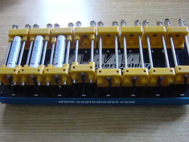

請問這是甚麼? 用來叉電?
不識用....只有日文說明書....
謝謝師兄
作者: -69-    時間: 2009-3-1 14:22
應該只是Battery Holder. 2A和3A電之用,可用來charge同放電用的電架。

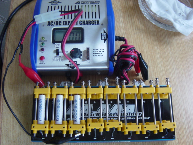

something like this....
作者: 2slow    時間: 2009-3-1 14:45
叉3cell示範
叉4cell 應該插返4cell果位
[ 本帖最後由 2slow 於 2009-3-1 14:48 編輯 ]

作者: bidforfuns    時間: 2009-3-2 00:32
原帖由 2slow 於 2009-3-1 14:42 發表
Any advantages of charging battery like this?
Coz I usually use the normal GP fast charger for charging AAA batteries.
作者: frienddicky    時間: 2009-3-2 00:40
佢係 將你d散電串聯埋一齊黎差,,.. ( like 你玩車排直或橫電餅咁 ),, 有乜好? 講真,, 吾知....... 一部差機可以一次差曬八粒啩.........

I have a LRP charger (several hundred stuffs) and can adjust current.
So I just connect the charger and the battery holder and charge the AAA battery on the holder?
What is the current I have to adjust?
Thanks
Adam

hi ching...
I don't know about LRP (pulsar?) chargers..
but I use Muchmore to charge my AAA's, settings as below...
current is set to 1.2a to 1.5a
delta peak is set to 0 to 3mv (per pack or 4 cells)
